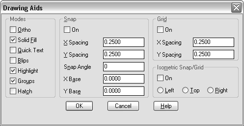

A dialog box consists of the box and the components within it.
In dialog box creation and customization these components are known as tiles. The basic tile types are predefined by the programmable dialog box (PDB) facility. The following figure shows a standard dialog box, with some of its components labeled.
