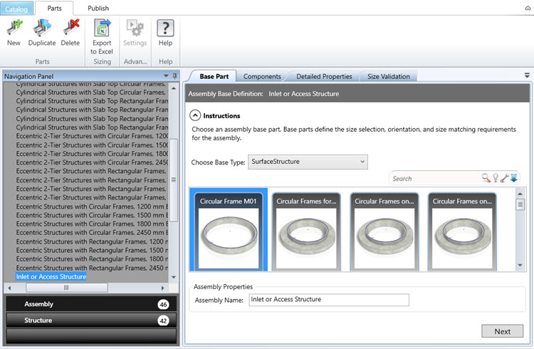

  1. Open the Parts Editor.
  2. Open a Drainage Structure or Piping catalog.
  3. Select an assembly name in the Navigation panel.
    • For a Drainage Structure this will be an Inlet or Access Structure assembly.
    • For Piping, this could be a Fastener, Fittings, Flange, Instruments, Olets, Pipes, Valves and Operators, or Miscellaneous assembly type.
  4. Right-click.
  5. Click New or Create Assembly.
    A generic assembly matching the assembly type you selected is added to the catalog. For example, in the Drainage Structure domain an "Inlet or Access Structure" assembly is created, depending on your selection.
  6. Input a name for the new assembly.
  7. Choose a base part family.
    Note: Surface Structure part families are the base part family for Inlet and Access Structure assemblies.
  8. Click Next.

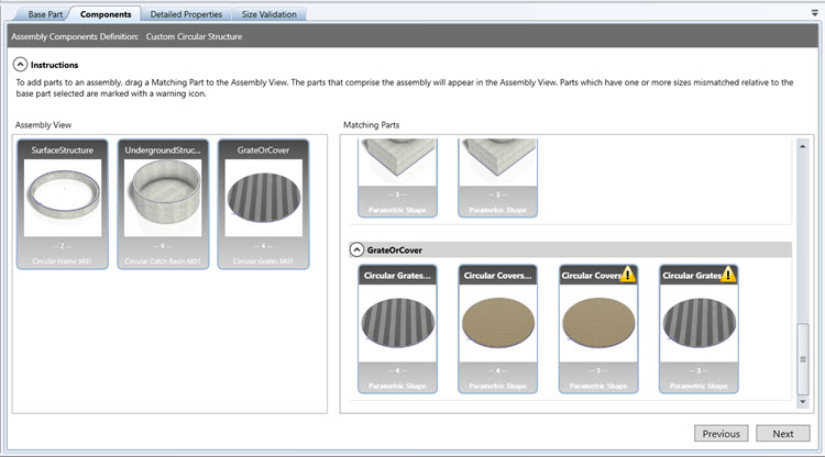

  9. Drag and drop Matching Parts families into the Assembly View.
    Note: Parts with one or more sizes mismatched relative to the base part selected are marked with a warning icon.
  10. Click Next.

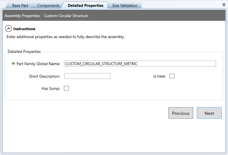

  11. Configure detailed properties.
    If the Assembly is an Inlet, checkmark Is Inlet.
    If the Assembly has a Sump, checkmark Has Sump.
  12. Click Next.

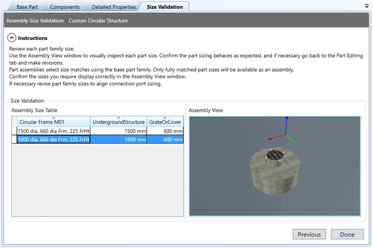

  13. Use Size Validation to visually inspect each part size.
  14. Click Done.
