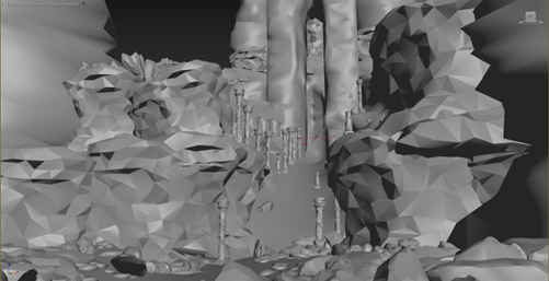

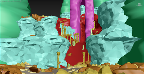

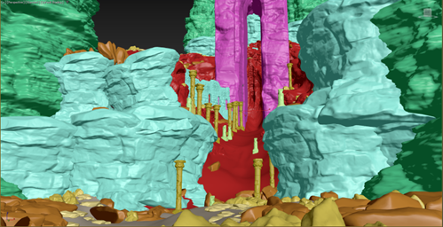

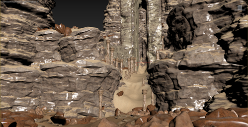

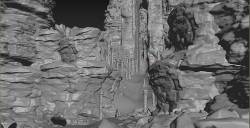

- Use the Show drop-down to select your display preference for the stage. To increase the performance of a stage, the default viewport setting is to show the stage using the stage node’s wire color or 3ds Max Wire Color. You can also display a stage with the USD Display Color (deriving colors from USD Prim data) or USD Preview Surface (which uses the imported material from USD).
Wire Color and Proxy
USD Display Color and Proxy
Wire Color and Render
USD Display Color and Render
USD Preview Surface and Render

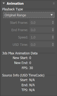

Animation
Use Playback Type settings to configure the animation of your USD stage. You can specify an original range, a custom range, a custom start and speed, or specific USD TimeCode.
Note: 3ds Max is set to 30 frames per second (FPS) by default so animations are often converted to a new start and end time (if the source USD animation doesn't match the scene's FPS). USD Souce animation info in this dialog is expressed in USD TimeCodes per second (TPS). 3ds Max Animation Data displays the result of converting the animation to 3ds Max data, matching the frames per second set in your 3ds Max scene, and applying playback settings.
