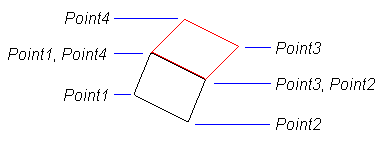

To create a three-sided face, omit the last point. Use the SetInvisibleEdge method to set the visibility of an edge.
Points must be entered sequentially in either a clockwise or counterclockwise direction to create a 3DFace object. You can create multiple adjacent faces by specifying the first two points of an additional face exactly as the last two points of the previous face.
