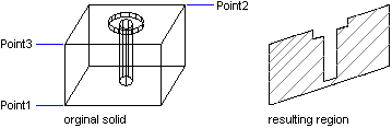

SectionSolid Method (ActiveX)
Creates a region that represents the intersection of a plane defined by three points and the solid.
Supported platforms: AutoCAD for Windows only; not supported in AutoCAD LT for Windows
Signature
VBA:
RetVal = object.SectionSolid(Point1, Point2, Point3)
object
Type: 3DSolid
The object this method applies to.
Point1
Access: Input-only
Type: Variant (three-element array of doubles)
The 3D WCS coordinates specifying the first point.
Point2
Access: Input-only
The 3D WCS coordinates specifying the second point.
Point3
Access: Input-only
The 3D WCS coordinates specifying the third point.
Return Value (RetVal)
Type: Region
The resulting section as a region.
