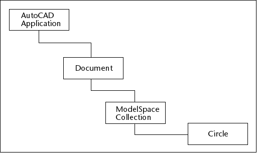

The statements in this example accomplished the following:
The hierarchical path traversed in the AutoCAD object model is pictured below:
