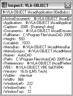

    • AutoCAD Only:
      1. In Visual LISP, click View Inspect.
      2. In the Inspect dialog box, Symbol box, enter the name of the variable you stored the object in. Click OK.
        Note: You can double-click a property to inspect is current value in another Inspect window. For example, you can double-click <Preferences> to view the properties of the Preferences object associated with the Application object.
