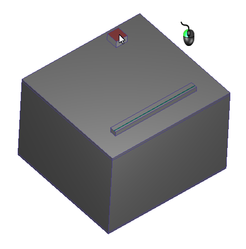

In this step, we define the return. This is easy because we use a gage pressure to represent where the exhausts to the return ducts.
Left click on the return surface.

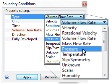

Click Edit from the Boundary Conditions context panel:

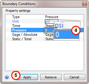

On the Type row, select Pressure.
Leave the Unit as Psi and the Pressure value = 0.
Click Apply.

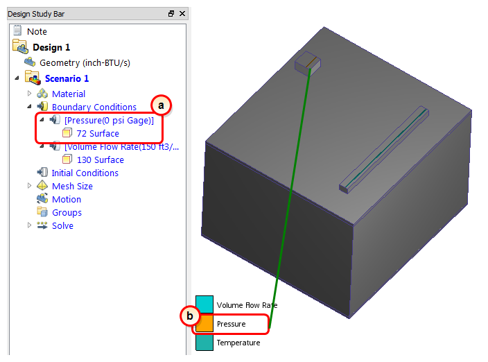

6. To verify that the boundary condition is correctly applied to the return, check the Design Study Bar and the colored stripe on the return surface:
On the Design Study bar, the Pressure condition should be listed with a value of 0 psi.
There should be a colored stripe on the return face that corresponds to the legend.
