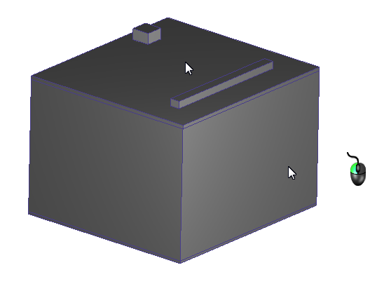

1. Select the wall and ceiling parts by left clicking on both:

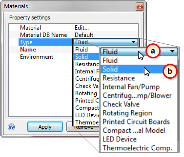

2. Click Edit from the Materials context panel:
3. On the Materials quick edit dialog, select the material type:
a. In the Type row, click in the right-side column.
b. Select Solid.

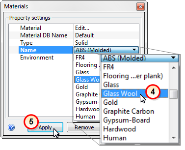

4. From the Name menu, select Glass wool.
5. Click Apply.

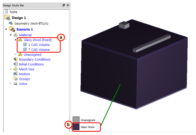

6. To verify that the glass wool material is properly assigned, check the Design Study Bar and the part coloring:
a. On the Design Study bar, confirm the material assignment for the Glass Wool parts.
b. The wall and ceiling parts should be colored to correspond to the Glass Wool color in the legend.
