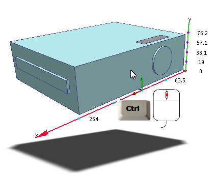

1. To start, hide the Air part by holding Ctrl and middle clicking on it:

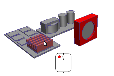

2. Select the heat sink by left clicking on it.

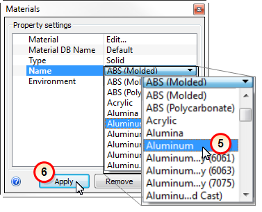

3. Click Edit from the Materials context panel:
4. On the Materials quick edit dialog, select the material type:
5. From the Name menu, select Aluminum.

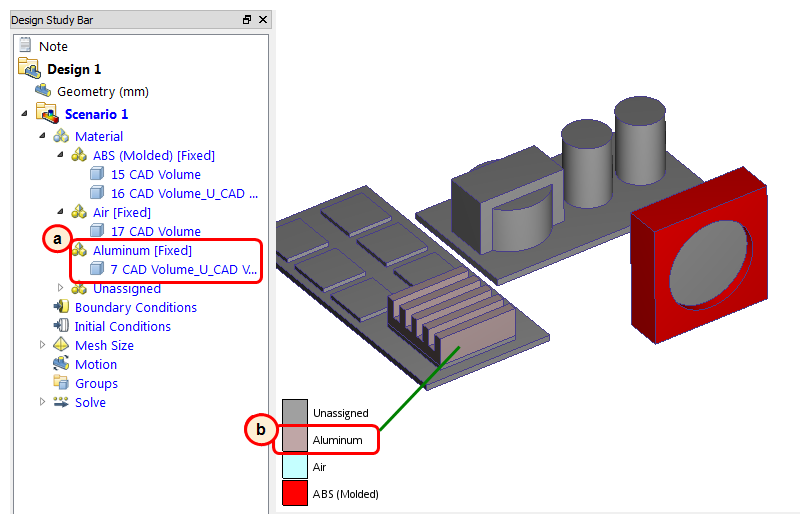

6. Click Apply.
What it should look like...
7. To verify that the aluminum material is properly assigned, check the Design Study Bar and the part coloring:
