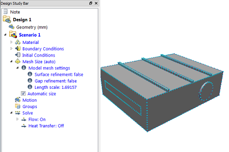

In this step, we configure the mesh distribution automatically.
1. Switch to the Mesh task by clicking Mesh Sizing from the Setup tab:
2. Click Autosize on the Automatic Sizing context panel:

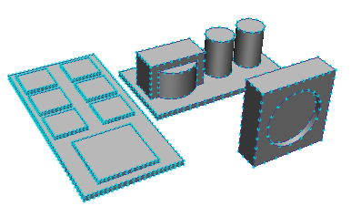

What it should look like...
You should see blue dots along every edge of the model. These dots provide a simple preview of the mesh distribution.
