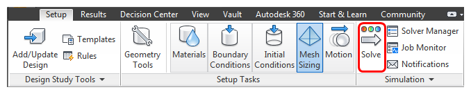

In this step, we start the flow simulation. It takes about 10 minutes to run.
Click Solve from the Setup tab:

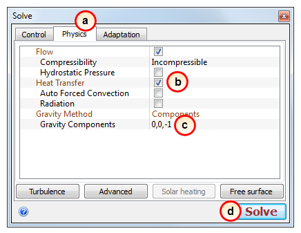

After we enable heat transfer and the gravity vector, we can start the simulation:
Click the Physics tab.
Check Heat Transfer.
Change the Gravity Direction to 0, 0, -1
Click Solve.

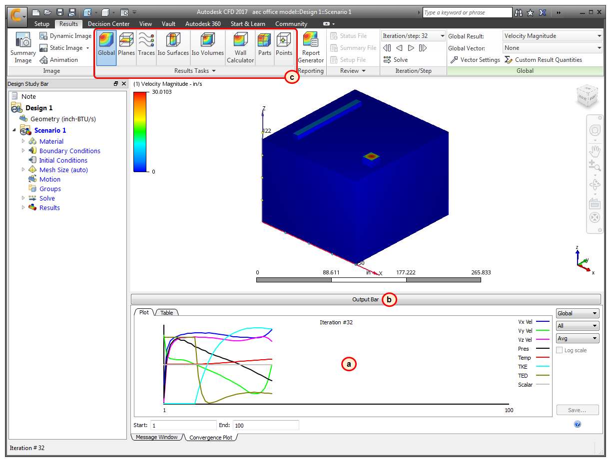

While it's running, you can see the results as they are computed!

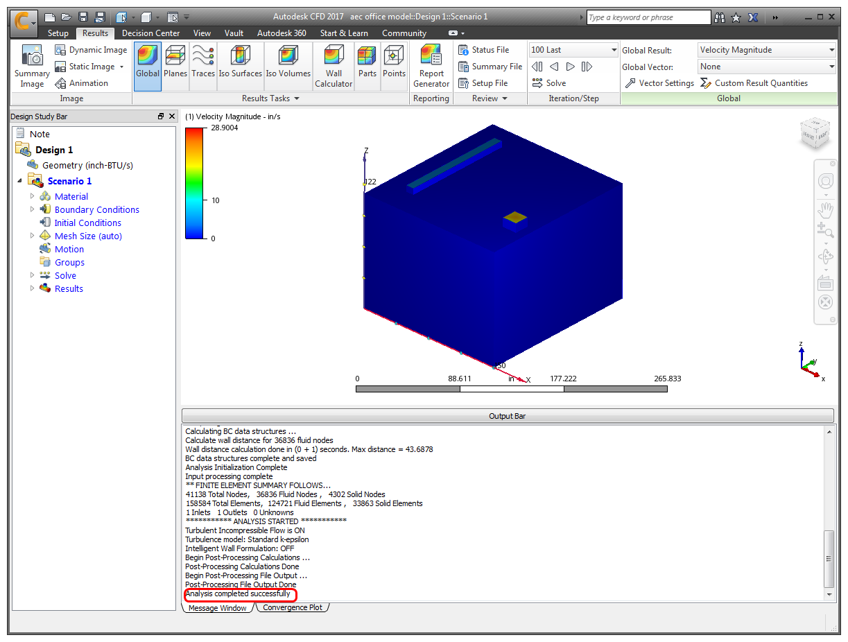

Here are some things to notice:
The Output bar displays "Analysis completed successfully" when the simulation finishes:
Next, we visualize the results!
