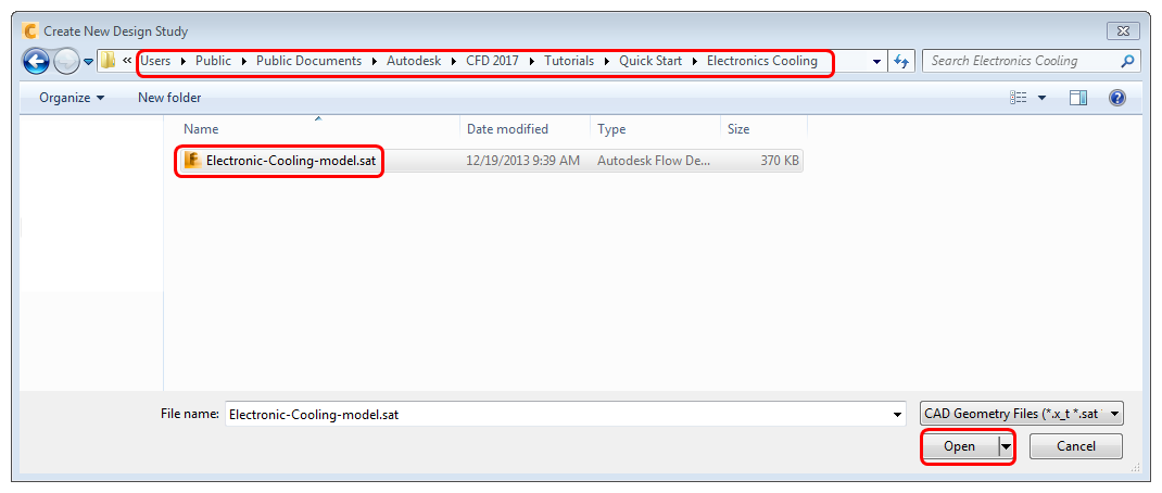

On the New Design Study dialog, click Browse...
Navigate to C:\Users\Public\Public Documents\Autodesk\CFD 2020\Tutorials\Quick Start\Electronics Cooling, and select Electronic-Cooling-model.sat. Click Open.

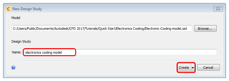

On the New Design Study dialog, enter the design study Name, make sure the button option is set to Create, and click Create:

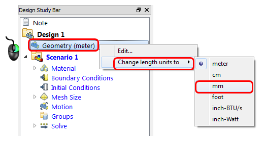

The geometry imports in units of meters, but we need to convert it to mm. To do this:
Right click on the Geometry branch of the Design Study Bar, select Change length units, and click on mm.
What it should look like:
