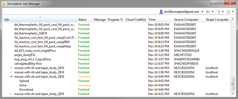

List View
Use the List view to monitor the progress of your jobs. If an error occurs that prevents successful completion, the List view lets you know the stage at which the error occurred.
Dialog element | Explanation |
Job | The Job list is a hierarchal list of your jobs. Jobs are grouped in chronological order in the following time-based groupings:
- Active: Any job that has an active task.
- Complete: Jobs that ended within the last seven days. (This includes both jobs that ended successfully and those that did not.)
Note: To change the number of days a job is displayed in the Complete group, modify the Number of days to show finished jobs in the General tab of the Preferences dialog box. Jobs are broken into three stages, each of which is listed as an individual sub-branch below the job: - Upload: The process of compressing and transferring an encrypted copy of the model to the Autodesk 360 secure storage service.
- Solve: The computational tasks performed by Autodesk 360. Examples include mesh generation and numerical calculation.
- Download: The process of copying the simulation results data from the Autodesk 360 secure storage service back to the local workstation.
Note: To view the tasks performed in each stage, enable Show Tasks on the tab of the Preferences dialog box. |
Status | Shows the current state of each stage in the simulation process. - Scheduled: The Job Manager is aware of the job, but has not initiated the stage.
- Queued: The Job Manager has initiated the stage, but the stage has not started.
- Running: The Job Manager has started the stage.
- Canceled: The job was halted because was selected on the right click menu.
- Failed: The stage did not successfully complete. This can be caused by several factors.
- Abandoned: The stage did not complete successfully. This can be due to network issues.
- Finished: The stage has completed successfully.
- When the Upload and Solve stage is finished, the next stage begins.
- To support download of intermediate results, there are times when the Download stage shows as Running at the same time as the Solve stage.
- When the Download stage reaches Finished, the simulation is complete and results are ready for visualization on the local computer.
Note: The status of the current stage is displayed adjacent to the job name. |
Message | This is the current stage of the job, and is displayed adjacent to the job name. |
Progress% | This is a measure of how much of the active stage has been completed successfully. |
Token(s) | This value indicates the cost of the job, in terms of Tokens. The column is populated only for Cloud jobs (and not Local jobs). |
Time | This is the date and time when the job or stage achieved a specific status. To view a detailed time history for all stages, open the Advanced tab of the Preferences dialog box, check Show time details, then click . The List view expands to show three time columns: - Schedule Time: The time when the job was first created.
- Start Time: The time when the stage started.
- Completed Time: The time when the stage finished.
Source Computer | This is the name of the computer from which the job was launched. |
Target Computer | This is the computer on which the analysis was performed. Note: To sort jobs by any of the values in the columns (such as Status, Progress, or Time), click the column label for the desired criteria. To invert the order, click the column label a second time. |
