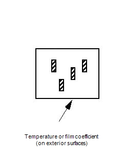

Either construct the flow volume in the CAD model or construct caps that fully enclose the flow volume. (This can be done using the Void Fill Geometry tool.) | ![]() |

Specify a temperature or film coefficient (convection) on the exterior surface of the housing.
