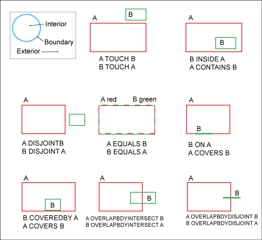

The SDO_RELATE operator performs both primary and secondary filter operations, where the mask parameter specifies the topological relation of interest.
Examples: Spatial Operator SDO_RELATE
Topological relations:
Oracle Spatial SDO_RELATE operator: Intersection patterns
Names of topological relationships:
These are the following spatial intersection patterns:
The interior and boundary of one object is completely contained in the interior of the other object.
The interior of one object is completely contained in the interior of the other object, and their boundaries intersect.
The opposite of COVERS. A COVEREDBY B implies that B COVERS A (Demarcations of two objects which partially cover themselves, and the interior of the other object is completely contained within the object).
The boundaries and interiors do not intersect.
The two objects have the same boundary and interior.
The opposite of CONTAINS. A INSIDE B implies that B CONTAINS A (Boundary and interior of one object are completely inside the other object).
The boundaries and interiors of the two objects intersect.
The interior of one object intersects the boundary and interior of the other object, but the two boundaries do not intersect. Example: When a line originates outside a polygon and ends inside that polygon.
The boundaries intersect, but the interiors do not intersect.
