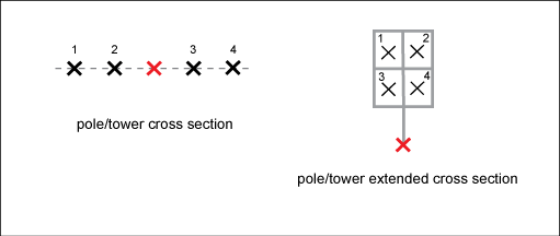

A pole or tower cross section is a view of a pole or tower looking down from the sky.
Tower with two conductors. The standard cross section displays two snap points for two more conductors. Use the standard cross section for data acquisition, and the extended cross section is for visualization only.
