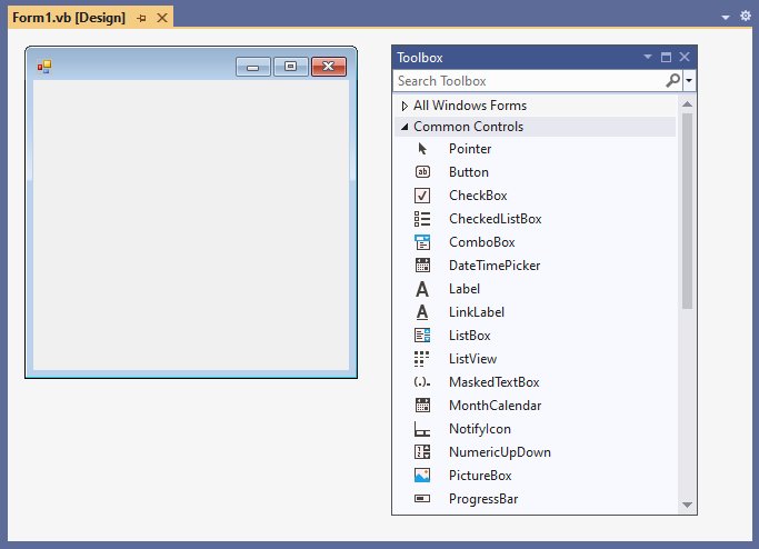

The Windows Form Designer allows you to create custom dialog boxes for your project.

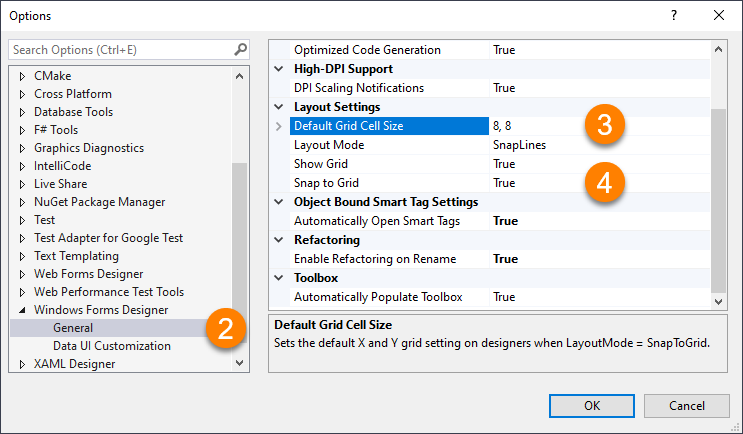

To add a control to a form, click the desired control from the Toolbox window to activate the tool, and then click over the form in the Windows Form Designer to place and size the control. You can align controls with a grid or other controls by setting the appropriate setting form from the General category under the Windows Form Designer folder in the Options dialog box. The General category allows you to control other grid related settings such as size and layout mode.
Each form that you design has the standard Maximize, Minimize, and Close buttons. These buttons are implemented as part of the Windows Form item template. You change the appearance and style of the dialog box by selecting the form object in the Windows Form Designer and then using the Properties window.

To enable snap and set the size for the grid
Options.
