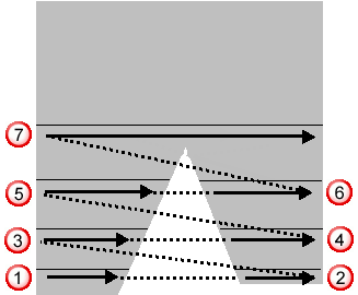

One way — The tool cuts in one direction:

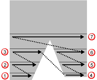

One way grouped — The tool cuts in one direction and PartMaker chooses the shortest distance between each toolpath segment:

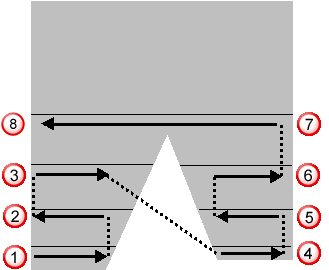

Two way — The tool can cut in two directions and the toolpath segments are joined with lead and link moves:
