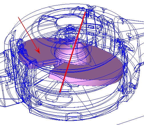

Tilt Axis
The tilt axis is the axis normal to the disk. As the disk nutates, this is the axis that is pinned at the Center of Nutation and rotates about the Axis of Nutation.
The Tilt Axis on an actual nutating device is shown:
tilt axis
Using the Pick Option, select the surface indicated in the graphic as the surface normal to the Tilt Axis. The resultant Tilt Axis is shown on the disk.
The absolute orientation of the tilt axis will change as the object nutates, but the orientation relative to the object will remain constant. The direction of this axis determines the direction of Nutation according the right hand rule convention.

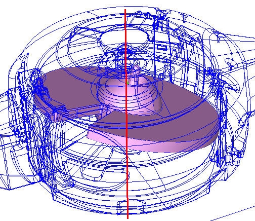

Axis of Nutation
The Axis of Nutation is the axis that remains constant throughout the nutation process.
Because this axis does not move, it is often convenient to construct the model such that a Cartesian axis is the Axis of Nutation. This allows easy specification of the axis. The Axis of Nutation is shown:
axis of nutation
In this case, the Axis of Nutation is the Global Y axis.

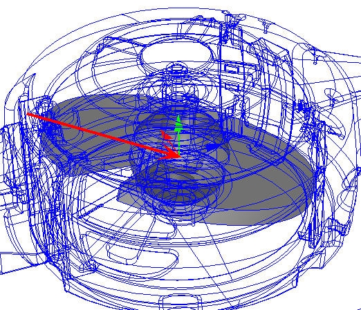

Center of Nutation
The Center of Nutation is the center point of the nutating object.
There are two ways to specify this:
The center point is the center of motion, and is typically the center of the object. Because of this, it is often convenient to construct the CAD model such that the center of the nutating object is at a known coordinate. In the example shown below, the Center of Nutation is actually the origin (0,0,0), which made defining it very easy:
center of nutation
The Center of Nutation in this model is at the origin.
