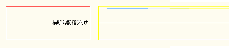

次の例では、路肩の外側の勾配を(右路肩は黄色、左路肩は青で)表示するデータ帯 スタイルを作成します。また、グレーの参照ラインも追加します。
Dim oBandSuperElevationStyle As AeccBandSuperElevationStyle
Set oBandSuperElevationStyle = oDocument.ProfileViewBandStyles _
.SuperElevationBandStyles.Add("Superelevation Band")
With oBandSuperElevationStyle
' Add graphical display of the slope of the left and right
' outside shoulders. If the line is above the centerline,
' then the slope is positive.
.LeftOutsideShoulderLineDisplayStylePlan.Visible = True
.LeftOutsideShoulderLineDisplayStylePlan.color = 151
' Color 151 = pale blue
.RightOutsideShoulderLineDisplayStylePlan.Visible = True
.RightOutsideShoulderLineDisplayStylePlan.color = 51
' Color 51 = pale yellow
' Add a reference line through the center of the data band.
.ReferenceLineDisplayStylePlan.Visible = True
.ReferenceLineDisplayStylePlan.color = 252 ' gray
' Modify how the title is displayed.
.TitleBoxDisplayStylePlan.color = 10 ' red
.TitleBoxDisplayStylePlan.Linetype = "DOT"
.TitleBoxDisplayStylePlan.Visible = True
.TitleBoxTextDisplayStylePlan.color = 80 ' green
.TitleBoxTextDisplayStylePlan.Visible = True
.TitleStyle.Text = "Profile Geometry"
.TitleStyle.TextHeight = 0.0125
.TitleStyle.TextBoxWidth = 0.21
' Hide the rest of the information locations and
' graphical displays.
.FullSuperLabelDisplayStylePlan.Visible = False
.FullSuperTickDisplayStylePlan.Visible = False
.LeftInsidePavementLineDisplayStylePlan.Visible = False
.LeftInsideShoulderLineDisplayStylePlan.Visible = False
.LeftOutsidePavementLineDisplayStylePlan.Visible = False
.LevelCrownLabelDisplayStylePlan.Visible = False
.LevelCrownTickDisplayStylePlan.Visible = False
.NormalCrownLabelDisplayStylePlan.Visible = False
.NormalCrownTickDisplayStylePlan.Visible = False
.ReverseCrownLabelDisplayStylePlan.Visible = False
.ReverseCrownTickDisplayStylePlan.Visible = False
.RightInsidePavementLineDisplayStylePlan.Visible = False
.RightInsideShoulderLineDisplayStylePlan.Visible = False
.RightOutsidePavementLineDisplayStylePlan.Visible = False
.ShoulderBreakOverLabelDisplayStylePlan.Visible = False
.ShoulderBreakOverTickDisplayStylePlan.Visible = False
.TransitionSegmentLabelDisplayStylePlan.Visible = False
End With
このスタイルは、次のようなデータ帯を生成します。
