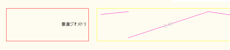

次の例は、縦断のすべてのセグメントの勾配方向をタイトルとともに表示するデータ帯スタイルの作成を示しています。
Dim oBandVerticalGeometryStyle As AeccBandVerticalGeometryStyle
Set oBandVerticalGeometryStyle = oDocument.ProfileViewBandStyles _
.VerticalGeometryBandStyles.Add("Vertical Band")
With oBandVerticalGeometryStyle
' Add graphical marks that show the uphill or downhill
' directions and the lengths of the vertical segments
' of the profile. On uphill sections the label of the
' length of the segment will be in white, on downhill
' it will be pale yellow. The graphical element that
' shows direction will be pink.
.DownhillTangentLabelStyle.TextComponents.Item(0).
Contents = "<[Tangent Horizontal Length(Uft|P2)]>"
.DownhillTangentLabelStyle.TextComponents.Item(0). _
Color = 51 ' pale yellow
Visibility = True
.UphillTangentLabelStyle.TextComponents.Item(0).
.UphillTangentLabelStyle.TextComponents.Item(0). _
Color = 255 ' white
Visibility = True
.TangentGeometryDisplayStylePlan.Color = 220 ' pink
.TangentGeometryDisplayStylePlan.Visible = True
.TangentLabelDisplayStylePlan.Visible = True
' Modify how the title is displayed.
.TitleBoxDisplayStylePlan.Color = 10 ' red
.TitleBoxDisplayStylePlan.Linetype = "DOT"
.TitleBoxDisplayStylePlan.Visible = True
.TitleBoxTextDisplayStylePlan.Color = 80 ' green
.TitleBoxTextDisplayStylePlan.Visible = True
.TitleStyle.Text = "Profile Geometry"
.TitleStyle.TextHeight = 0.0125
.TitleStyle.TextBoxWidth = 0.21
' Hide the rest of the information locations and
' graphical displays.
.CurveGeometryDisplayStylePlan.Visible = False
.CurveLabelDisplayStylePlan.Visible = False
.TickDisplayStylePlan.Visible = False
End With
このスタイルは、次のようなデータ帯を生成します。
