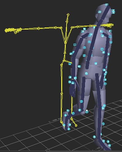

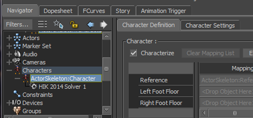

Create a skeleton from the actor. CreateSkeletonForActor(pActor,pPrefix) creates a skeleton as shown in the following figure.

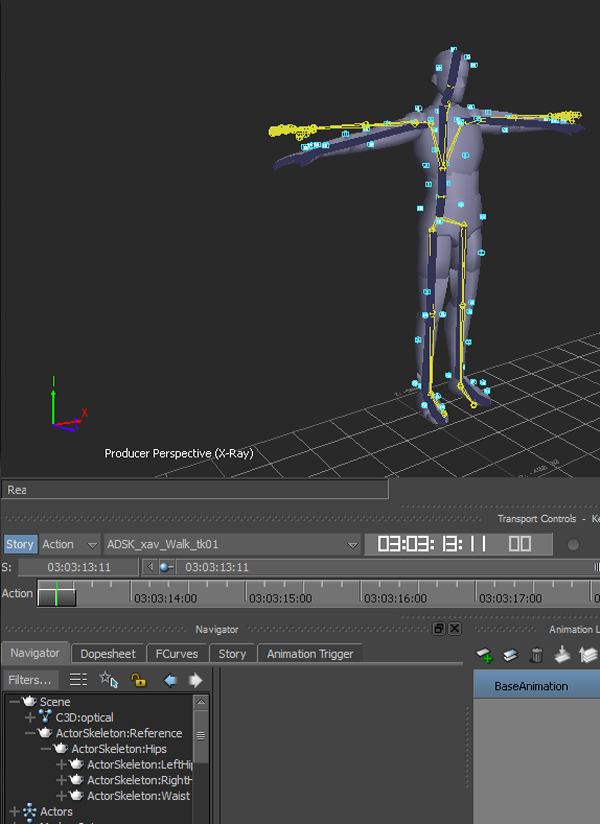

Set up the characterization and lock the character. CharacterizeActorSkeleton(pPrefix) characterizes the skeleton.
Prepare for snap.
Move the cursor forward so that the skeleton is not following the actor.

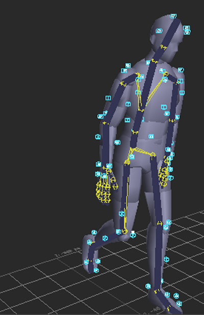

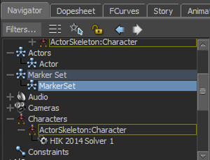

Snap markers on the character marker set. Initially, there is no marker for the character as shown in the following figure.

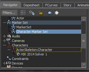

CopyMarkerMappingFromActorToCharacter(lChar, pActor) creates a marker set for the character, then snaps the actor’s markers to the character’s marker set. It uses lMarkersProp.ConnectSrc(lMarker) to connect the character's marker property with the actor’s marker. The actor’s marker is the driving source. The character marker set is shown in the following figure.

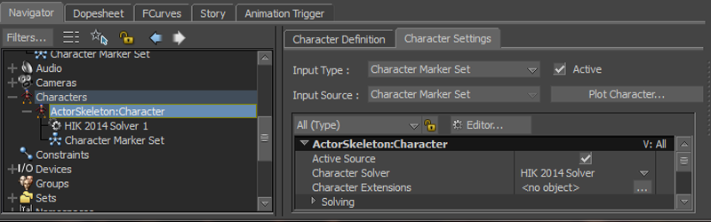

Set the character marker as the input. Then, set the character's input to its character marker set that is created in the previous step, and set the input as active.

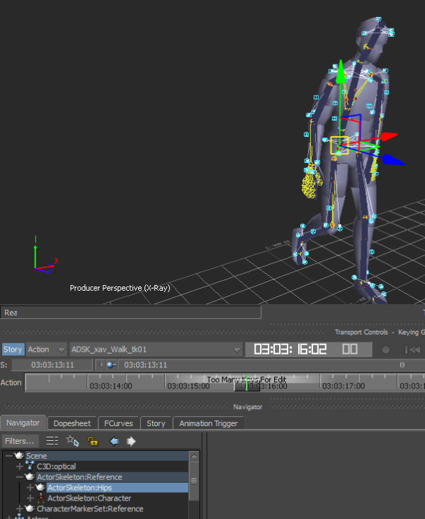

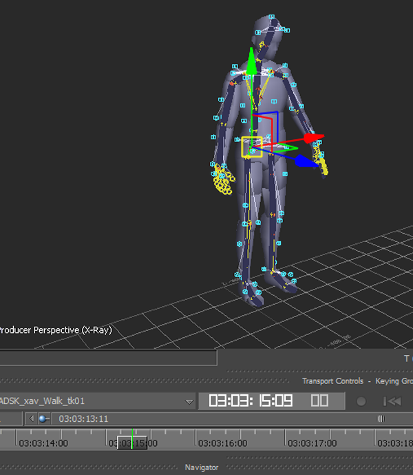

Plot the animation to the skeleton. You can play the character with the animation. However, the character's skeleton does not contain the animation. You can select the hip of the skeleton to see that there is no animation.
lChar.PlotAnimation() can plot the animation to the character’s skeleton or control rig. Running this step plots the animation to the skeleton.
Now, the skeleton contains the animation that you can export as an animation clip.
