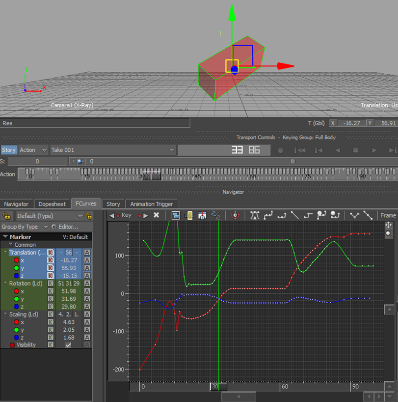

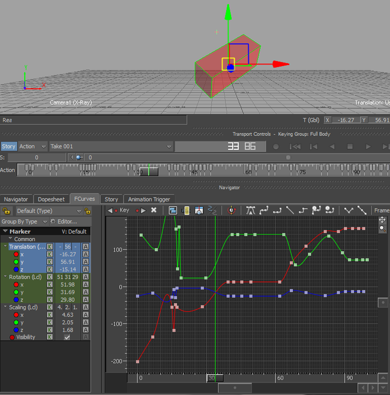

  1. Open the filters_butterworth.fbx file in MotionBuilder.
  2. Run the filters_butterworth.py script to remove the noise in the FCurve. The FCurves appear smooth as shown in the following figure.
