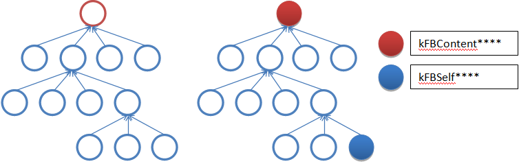

A self dirty flag is put on the item and a content dirty flag is put on the reference object whenever the referenced item changes. The following figure illustrates this concept.
The red circle represents the reference object and the blue circle represents the referenced items. The result after the dirty flags are set is shown on the right.

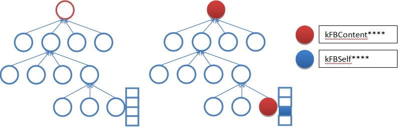

If a property of a referenced item changes, a self dirty flag is put on the property and a content dirty flag is put on the reference object. The following figure illustrates this concept. The blue boxes represent the properties of a referenced item. The result after the dirty flags are set is shown on the right.
