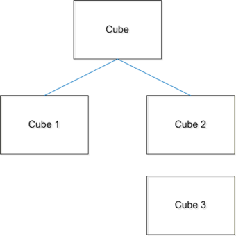

Consider a scene named abc.fbx that contains a couple of cubes as shown in the following figure.

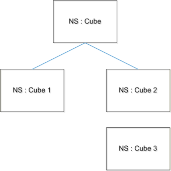

This creates a scene structure as shown in the following figure.

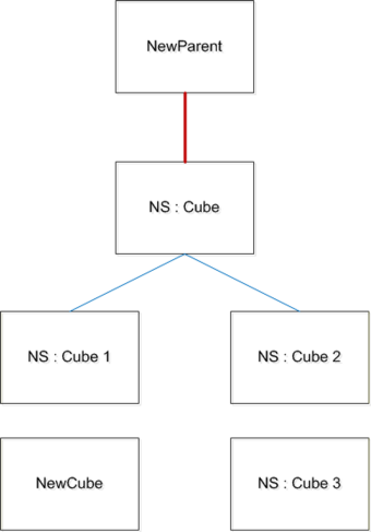

NS:Cube does not have a parent, so it can be parented to another scene object even though it belongs to the reference object. This can be achieved through the following script.
lParentCube = FBModelCube( "NewParent" )
lParentCube.Show = True
lNSCube = FBFindObjectByFullName( "Model::NS:Cube" )
lNSCube.Parent = lParentCube

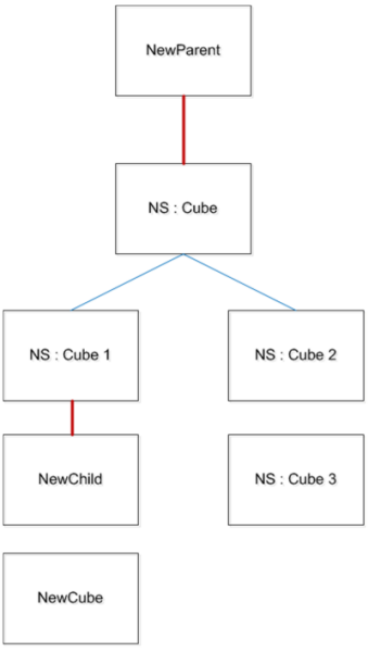

NS:Cube 1 is the leaf node in the reference object, so it can be the parent of a non-referenced scene object. The following script parents a new scene object to NS:Cube 1.
lChildCube = FBModelCube( "NewChild" )
lChildCube.Show = True
lNSCube1 = FBFindObjectByFullName( "Model::NS:Cube 1" )
lChildCube.Parent = lNSCube1
