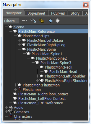

You can use namespaces to facilitate object organization. For example, you can assign a namespace to the various body parts (FBModel
) of a character (FBCharacter
) in a scene. This helps you identify the character to which a body part belongs. In the following image, PlasticMan:Hips
refers to the hips of the PlasticMan character, identified by the PlasticMan
namespace.
