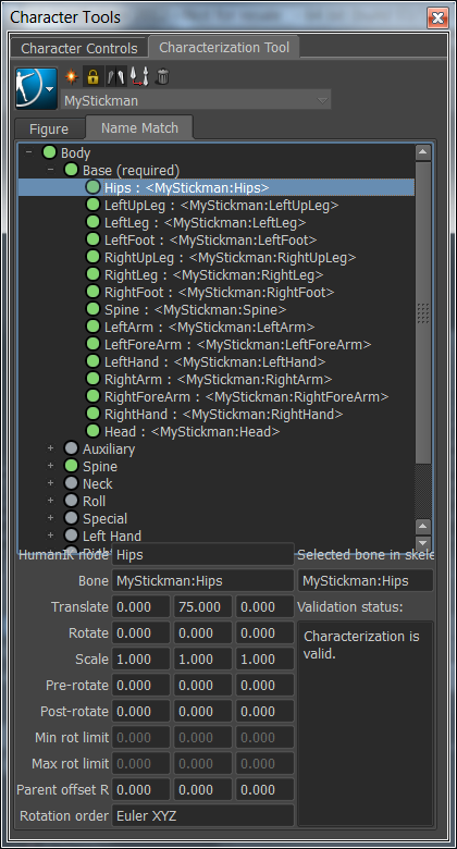

An FBCharacter
is said to be "characterized" if a minimal hierarchy of FBModel
has been assigned to the "Base" (required) character slots. The following list presents the names of these required character slots: HipsLink
, LeftUpLegLink
, LeftLegLink
, LeftFootLink
, RightUpLegLink
, RightLegLink
, RightFootLink
, SpineLink
, LeftArmLink
, LeftForeArmLink
, LeftHandLink
, RightArmLink
, RightForeArmLink
, RightHandLink
, HeadLink
. The image below shows a valid characterization of the required character slots.
When the required slots have been associated with a joint in a skeleton, the FBCharacter.SetCharacterizeOn()
function may be called with the True
parameter. When a character is successfully characterized, an inverse and/or forward kinematic control rig may be created using FBCharacter.CreateControlRig()
. To display and use this control rig, set the FBCharacter.ActiveInput
property to True
The code below is taken from Example: Creating a Character, and illustrates how to characterize a skeleton.

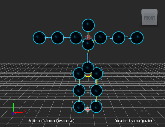

Sample Viewport Output:
Program Summary: The program below first defines a template which will be used to create a hierarchy of FBModelSkeleton
joints. The joint names are important here because they correspond to MotionBuilder's most basic biped characterization naming template.
Once the skeleton is created, we apply cartoon-shaded spheres to each joint to make our character more visually appealing. In practice however, we would assign a mesh to the skeleton's 'Reference'
model. The vertices of this mesh would be weighted according to the character's bones. This lengthy process is omitted for clarity.
The program concludes by characterizing the skeleton, and creating a forward- and inverse-kinematic control rig.

# Apply a copy of pModel to each joint in the skeleton.
def applyModelToSkeleton(pSkeleton, pModel):
# Create a copy of the model for each joint in the skeleton.
for jointName, joint in pSkeleton.items():
if jointName == 'Reference':
# Do not apply the model to the Reference node.
continue
# Parent the copied model to the joint.
model = pModel.Clone()
model.Parent = joint
model.Show = True
# Use the joint name as a prefix.
model.Name = jointName + pModel.Name
# Reset the model's translation to place it at the same
# location as its parent joint.
model.Translation = FBVector3d(0, 0, 0)
# Characterize the skeleton and create a control rig.
def characterizeSkeleton(pCharacterName, pSkeleton):
# Create a new character.
character = FBCharacter(pCharacterName)
FBApplication().CurrentCharacter = character
# Add each joint in our skeleton to the character.
slot = character.PropertyList.Find(jointName + 'Link')
slot.append(joint)
# Flag that the character has been characterized.
character.SetCharacterizeOn(True)
# Create a control rig using Forward and Inverse Kinematics,
# as specified by the "True" parameter.
character.CreateControlRig(True)
# Set the control rig to active.
character.ActiveInput = True
return character
# Main. #
# Clear the scene.
FBApplication().FileNew()
# Create a new skeleton.
characterName = 'MyStickman'
skeleton = createSkeleton(characterName)
# Apply a model to each limb of the skeleton.
templateModel = createModel()
applyModelToSkeleton(skeleton, templateModel)
templateModel.FBDelete() # We do not need the template model anymore.
character = characterizeSkeleton(characterName, skeleton)
