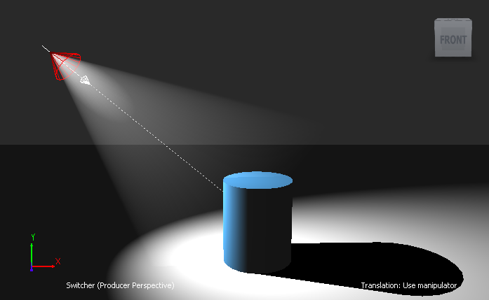

Program Summary: The program below creates a plane (FBModelPlane
), a blue cylinder (FBModel
), and a spotlight (FBLight
) pointing at the cylinder. The Dynamic Lighting
shader is bound to the plane and the cylinder to allow the light to project onto their surfaces. The Live Shadow
shader is bound to the plane to allow the cylinder's shadow to project onto the plane's surface.
from pyfbsdk import *
# Helper Function(s). #
# Create a spotlight positioned at pTranslation, which will
# shine light on pModel.
def createSpotlight(pTranslation, pModel):
light = FBLight('myLight')
light.LightType = FBLightType.kFBLightTypeSpot
light.Intensity = 200
light.ConeAngle = 70
light.FogIntensity = 20
light.Show = True
light.Translation = pTranslation
light.LookAt = pModel
return light
# Create a large plane.
def createPlane():
plane = FBModelPlane('myPlane')
plane.Translation = FBVector3d(0, 1, 0)
plane.Scaling = FBVector3d(5, 0, 5)
plane.Show = True
return plane
# Create a cylinder.
def createCylinder():
cylinder = FBCreateObject( 'Browsing/Templates/Elements/Primitives', 'Cylinder', 'Cylinder' )
cylinder.Scaling = FBVector3d(5, 3, 5)
cylinder.Translation = FBVector3d(0, 30, 0)
cylinder.Show = True
return cylinder
# Create a blue material.
def createMaterial():
material = FBMaterial('myMaterial')
material.Diffuse = FBColor(0.25, 0.56, 0.8)
return material
# Create a live shadow shader. This shader projects the shadow of an occluding
# object onto a surface.
def createLiveShadowShader():
shader = FBCreateObject('Browsing/Templates/Shading Elements/Shaders', 'Live Shadow', 'myLiveShadowShader')
return shader
# Create a dynamic lighting shader. This shader projects light dynamically
# onto surfaces.
def createDynamicLightingShader():
shader = FBCreateObject('Browsing/Templates/Shading Elements/Shaders', 'Dynamic Lighting', 'myDynamicLightingShader')
return shader
# Main. #
# Clear the scene.
FBApplication().FileNew()
# Create a plane and a cylinder.
plane = createPlane()
cylinder = createCylinder()
# Create a material to apply to the cylinder.
material = createMaterial()
cylinder.Materials.append(material)
# Create a spotlight looking at the cylinder.
light = createSpotlight(FBVector3d(-150, 150, -20), cylinder)
# Create the live shadow and dynamic lighting shaders.
liveShadow = createLiveShadowShader()
dynamicLighting = createDynamicLightingShader()
# Apply the shaders to the plane.
plane.Shaders.append(liveShadow)
plane.Shaders.append(dynamicLighting)
plane.ShadingMode = FBModelShadingMode.kFBModelShadingDefault
# Apply the dynamic lighting shader to the cylinder.
cylinder.Shaders.append(dynamicLighting)
cylinder.ShadingMode = FBModelShadingMode.kFBModelShadingDefault
