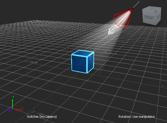

Sample Viewport Output:
Program Summary: The following program presents a broad overview of how to add various objects to the scene, including cameras, lights, materials, shaders, i/o devices, and constraints.

# Output. #
Scene graph:
Scene - FBModel
myCube - FBModel
myLight - FBLight
myCamera - FBCamera
Scene contents by type:
Materials
DefaultMaterial: FBMaterial
myMaterial: FBMaterial
Shaders
Default Shader: FBShaderLighted
myShader: FBShader
Cameras
Producer Perspective: FBCamera
Producer Front: FBCamera
Producer Back: FBCamera
Producer Right: FBCamera
Producer Left: FBCamera
Producer Top: FBCamera
Producer Bottom: FBCamera
myCamera: FBCamera
Lights
myLight: FBLight
Devices
myKeyboard: FBDevice
Constraints
Shot Track: FBStoryTrack
myConstraintRelation: FBConstraintRelation
