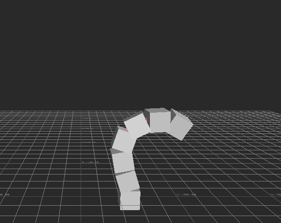

Sample Viewport Output:
Program Summary: The program below begins by creating a chain of cube primitives, arranged in a sequential parent-child hierarchy. The base cube of this chain is passively rooted on the ground plane and every other cube is assigned an active Rigid Body Physical Property.
An instance of FBModelNull
is inserted between each parent-child pair in the cube chain to identify each joint's point of rotation. A single Joint Physical Property object is then used to constrain the chain's movement. Lastly, the Physics Solver's 'Gravity'
property is set to (0, 9.81, 0)
to invert the force of gravity in the scene.
