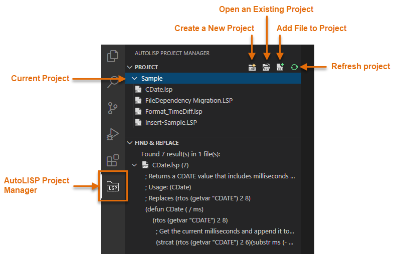

AutoLISP projects allow you to logically group AutoLISP source (LSP) files. An AutoLISP project is saved to a file with the .prj extension. PRJ files contain references to LSP files that are already stored in a local or network folder, or a folder that represents a git repository. The AutoCAD AutoLISP Extension defines a view on the Activity bar named AutoLISP Project Manager from which you can create and open PRJ files.

		The AutoLISP Project Manager consists of two panes; PROJECT and FIND & REPLACE.
The following explains the tools that are part of each pane.
Contains tools used to create and open an AutoLISP project from which you can manage your AutoLISP source (LSP) files.
Current Project
Name of the project currently open in the AutoLISP Project Manager.
Toolbar
 - Creates a new AutoLISP project.
		   - Opens a previously saved AutoLISP project.
		   - Adds an AutoLISP source (LSP) file to the current project.
		   - Refreshes the current project.

Contains tools used to find and replace text strings within the AutoLISP source (LSP) files that are in the current project.
Toolbar
 - Displays the Find in Project dialog box. This dialog box allows you to enter the text string to search for and specify the match options to use during the search.
		   - Displays the Find in Project and Replace in Project dialog boxes. Theses dialog boxes allow you to enter the text string to search for and replace with, and specify the match options to use during the search.
		   - Cancels the search for the text string in the LSP files.
		   - Clears the entries from the Search results list.
