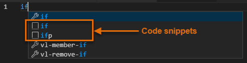

As you type in the editor window of an open AutoLISP source (LSP) or DCL file, the AutoCAD AutoLISP Extension displays a list of suggested functions and code snippets that match the characters typed. The more characters you type, the less items that will be displayed in the list. Select an item in the list to complete the function name or use the code snippet, you can also use the arrow keys to highlight the item to use and then press Tab to complete that item.

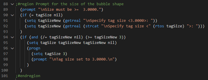

VS Code automatically defines what are known as regions based on AutoLISP statements or DCL definitions that span multiple lines. A region can be expanded or collapsed to minimize the number of code statements currently displayed in the editor window. User-defined regions can also be inserted to group multiple statements and regions, also referred to as subregions, into a single collapsible region.
A user-defined region starts with the comment ;#region and ends with the comment ;#endregion. Since these are comments, you can add descriptive text after each to explain the use of the statements and definitions in the region.
			 Small code blocks or samples, known as code snippets, are supported by the AutoCAD AutoLISP Extension. Code snippets can be used to quickly add the necessary syntax for commonly used functions or complex code blocks. For example, the AutoCAD AutoLISP Extension has a code snippet named ifp which is short for If… Progn and it contains an if statement with a nested progn statement. Typing ifp in the code editor and pressing Tab allows you to insert the code snippet.
Code snippets are part of the AutoComplete feature in VS Code and are prefixed by a square icon rather than a wrench used to indicate the name of an AutoLISP function.
The AutoCAD AutoLISP Extension codes ships with 60+ code snippets, here are a few of the code snippets that come with the AutoCAD AutoLISP Extension:
