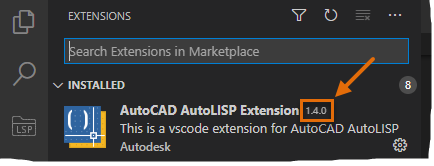

How you configure the AutoLISP Extension for debug depends on which version you are using. The following steps explain how to identify which version of the extension you are using:
- In Visual Studio Code, click File menu > Preferences > Extensions.
- In the Extensions view, clear any text from the Search box.
- Under the INSTALLED section, locate AutoCAD AutoLISP Extension in the list.
	 The version number of the extension will be next to its name.

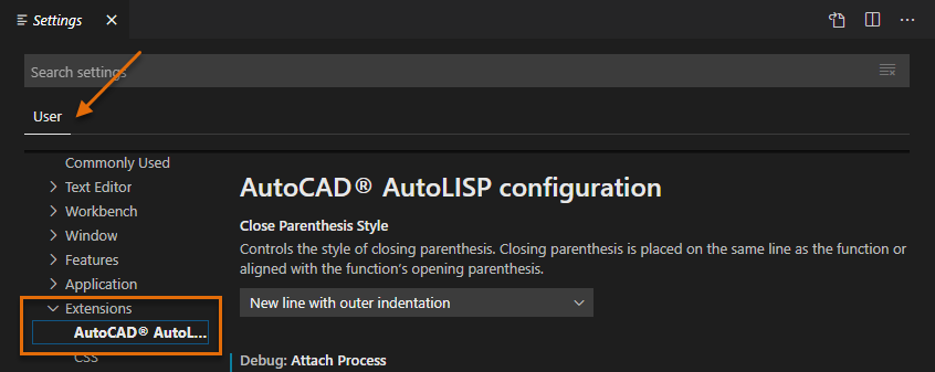

  - In Visual Studio Code, click File menu > Preferences > Settings.
- On the User tab, expand Extensions and click AutoCAD AutoLISP Configuration.

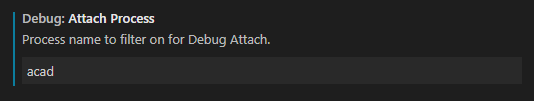

- In the Debug: Attach Process text box, enter one of the following values in bold:
		- (Windows)
			 acad
- (Mac OS)
			 AutoCAD
   Note: The process name is case sensitive, so acad or AutoCAD isn’t the same as ACAD or autocad.

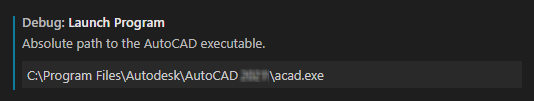

- In the Debug: Launch Program text box, enter the absolute path to the AutoCAD executable.
		The absolute path varies based on the release and platform on which AutoCAD was installed.
		 - (Windows)
			 "C:\Program Files\Autodesk\AutoCAD
				2024\acad.exe"
- (Mac OS)
			 "/Applications/Autodesk/AutoCAD
				2024/AutoCAD
				2024.app/Contents/MacOS/AutoCAD"

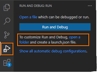

Setting up attach and launch configurations per folder (Version 1.3.2 and Earlier)
  Note: A folder must be opened before debug configurations can be added, and debug configurations should not be added to a workspace but to a folder only. See
To Open a Folder for steps on opening a folder.

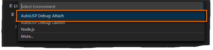

  - In Visual Studio Code, on the Activity Bar, click Debug and then click Create a launch.json File (or click Debug menu > Open Configurations).
- On the Configurations menu, choose AutoLISP Debug: Attach.

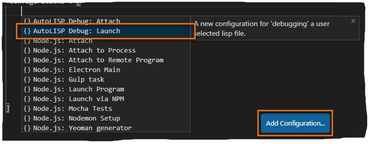

- In the editor window, lower-right corner, click Add Configuration and then choose AutoLISP Debug: Launch from the list that is displayed.
