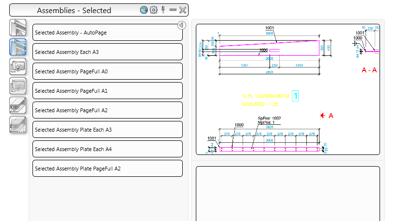

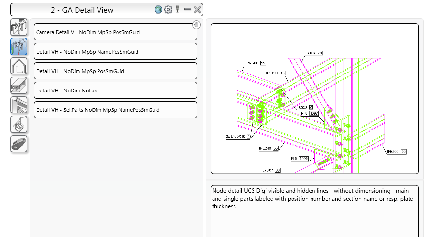

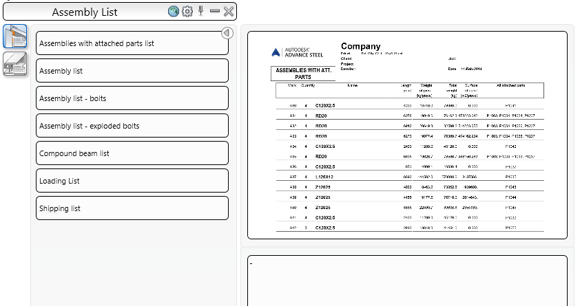

The tools for creating drawings are grouped in the Quick documents Palettes
The palettes allow you to quickly browse and use drawing styles and drawing processes for drawing creations as well as list templates for BOM list creations. The categories are represented by intuitive images.
| Palette | Quick Documents Palette name |
Drawing Styles palette |
Drawing Processes palette |
BOM Templates palette |
