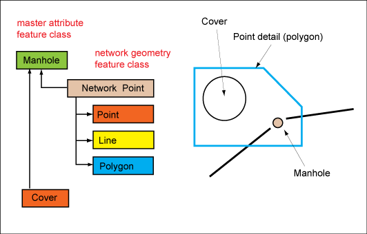

For network points, you can create geometry details, for example to illustrate complex manholes in the drawing. These are geometry feature classes that normally contain only attributes for representation, for example, line type. All other attribute data is stored with the master attribute feature class.
A network point can have related geometry in the drawing. Only the manhole is part of the network topology.

You can create one polygon detail for each network point. You can add any number of point and line details.
