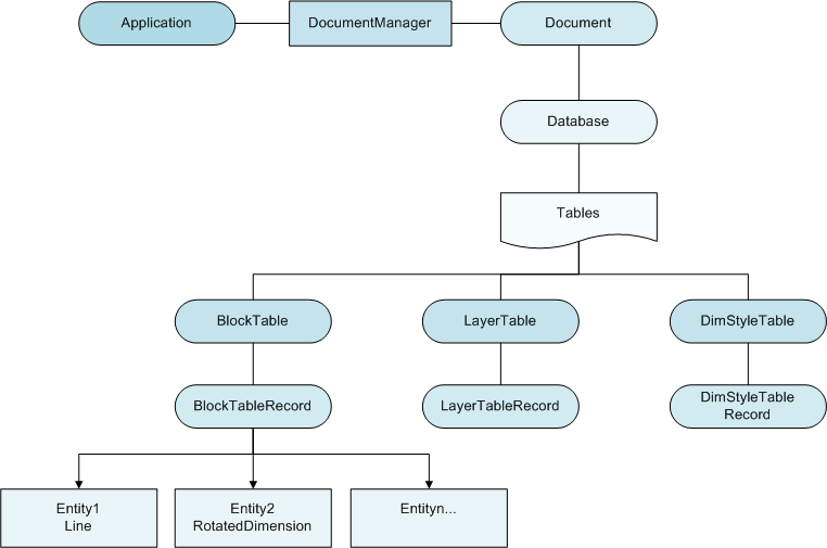

The objects are structured in a hierarchical fashion, with the AutoCAD Application object at the root. This hierarchical structure is often referred to as the Object Model. The following illustration shows the basic relationships between the Application object and an entity that is in a BlockTableRecord, such as Model space. There are many more objects in the AutoCAD .NET API that are not represented here.
