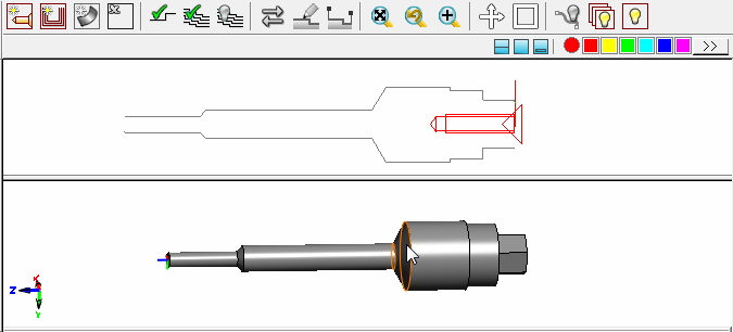

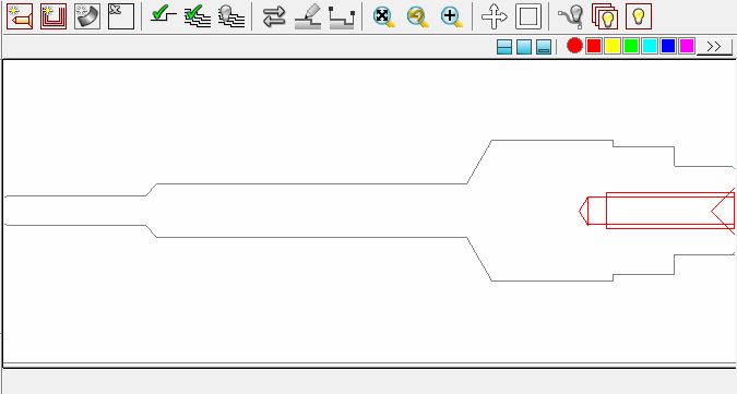

Use this menu option to display a single Face window for the currently selected Face in the Job Explorer pane. The window expands to fill the space available in the main PartMaker window. The Face window has no title bar and remains in a fixed position, but it gives you a larger working area. For example:
If you are using a Solids window, this window is embedded into the active Face window.
