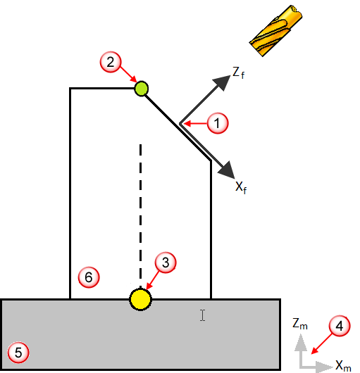

Global Origin — Specify the origin of the Global Coordinate system using the part origin, the center of the top table surface, or auser-defined point.
) in the Machine axes (see
This shows the Face Coordinate System on the part.
This shows the Part Origin.
This shows the Table Top Center.
This shows the machine axes.
This shows Vertical Rotary table.
This shows the stock.
