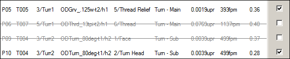

Status — When the Status option is selected for a process, PartMaker includes the process in simulation and in postprocessing.
You can select or deselect individual processes by clicking the Status check box for that process.
To enable or disable the Status option for all processes in the table, click
on the Process Table toolbar:
PartMaker uses a strikethrough to denote processes that are excluded from simulation and postprocessing. For example:
