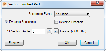

This dialog enables you to perform sectioning along Z-axis with specified angle.
Sectional Plane — Select the plane in which you want to make the section.
Dynamic Sectioning — Select to enable you to dynamically section the part using the arrow buttons
Reverse Direction — Select to reverse the direction in which the part is sectioned.
— Click to increment/decrement the ZX angle value and perform dynamic sectioning along the Z-axis. The sectioning increment/decrement is 10 degrees.
will modify ZX Section Angle only.ZX Sectioning Angle — Specify the ZX Section Angle where the part will be sectioned.
Range — The min and max angles are displayed.
Preview — Click to preview sectioning at specified ZX Sectioning Angle.
OK — Click to section the finished part and close the dialog.
