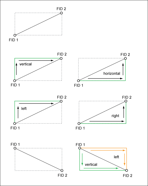

Direction Priority
Applies to Orthogonal schema plans.
Specifies the priority of the direction in which the schematic features are drawn.
  • Horizontal
  • Vertical
  • Left
  • Right

Direction Priority
For orthogonal schema plans, specifies the priority of the direction in which the schematic features are drawn.
The direction of the lines between two points is derived from the FID. For example, a line will be created from FID 1 to FID 2, either starting vertically, horizontally, drawing the line left to the real world feature, or drawing the line right to the real world feature.

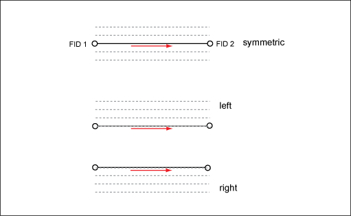

Multiline Offset and Distribution (Electric CE)
In the Electric CE data model, you can specify the multiline offset and distribution, both for orthogonal and geoschematic plans.
The left or right distribution direction is defined by the FID.
