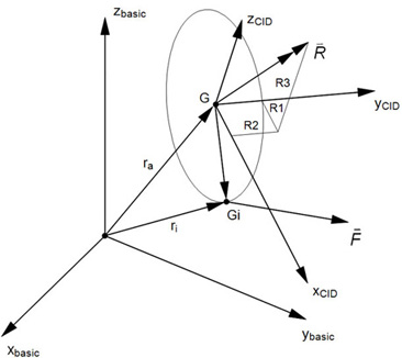

is the translational mass matrix at grid point Gi
Figure 1. RFORCE Vector at Grid Point Gi
