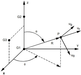

- The location of a grid point (P in the sketch) in this coordinate system is given by (R, θ, ɸ) where θ and ɸ are measured in degrees).
- The displacement coordinate directions at P are dependent on the location of P as shown below by (
- Points on the z-axis may not have their displacement directions defined in this coordinate system since ambiguity results. In this case the basic rectangular system will be used.
Figure 1. CORD1S Definition
