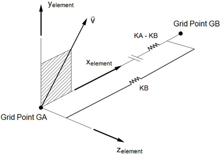

CID | Element coordinate system identification number. CID must be specified if GA and GB are coincident. See Remark 7. | Integer ≥ 0 or blank |
Remarks:
Figure 1. CGAP Element Coordinate System
