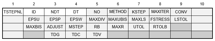

Description: Defines a set of parameters for nonlinear transient analysis.
Format:
Example:
Field | Definition | Type | Default |
ID | Identification number. | Integer > 0 | Required |
NDT | Number of time steps of value DT. See Remark 2. | Integer > 0 | Required |
DT | Time increment. See Remark 2. | Real > 0.0 | Required |
NO | Time step interval for output. Every NOi-th step will be output. See Remark 3. | Integer > 0 | 1 |
METHOD | Method for controlling stiffness updates, one of the following character variables: AUTO, TSTEP, or ADAPT. See Remark 4. | Character | ADAPT |
KSTEP | Number of time steps before stiffness update for the TSTEP method. See Remark 4. | Integer > 0 | 5 |
MAXITER | Limit on number of iterations for each time step. See Remark 5. | Integer > 0 or AUTO | AUTO |
CONV | Convergence criteria, one of the following character variables: U, P, or W, or any combination. See Remark 6. | Character | PW |
EPSU | Error tolerance for displacement (U) criterion. | Real > 0.0 | See Remark 17 |
EPSP | Error tolerance for load (P) criterion. | Real > 0.0 | See Remark 17 |
EPSW | Error tolerance for work (W) criterion. | Real > 0.0 | See Remark 17 |
MAXDIV | Limit on probable divergence conditions per iteration before the solution is assumed to diverge. See Remark 7. | Integer > 0 | 3 |
MAXUBIS | Maximum number of iterations for an upward load increment adjustment. Applicable when the load increment is bisected. | Integer > 0 | 7 |
MAXLS | Maximum number of line searches for each iteration. See Remark 8. | Integer ≥ 0 | 4 |
FSTRESS | Fraction of effective stress (![]() |
0.0 < Real < 1.0 | 0.2 |
LSTOL | Line search tolerance. See Remark 8. | 0.01 < Real ≤ 0.9 | 0.5 |
MAXBIS | Maximum number of bisections allowed for each time step. See Remark 10. | Integer > 0 | 5 |
ADJUST | Time step skip factor for automatic time step adjustment. See Remark 11. | Integer ≥ 0 | 5 |
MSTEP | Number of steps to obtain the dominant period response. See Remark 12. | 10 ≤ Integer ≤ 200 | Variable between 20 and 40 |
RB | Bounds for maintaining the same time step for the stepping function. See Remark 12. | 0.1 ≤ Real ≤ 1.0 | 0.75 |
MAXR | Maximum ratio for the adjusted incremental time relative to DT allowed for time step adjustment. See Remark 13. | 1.0 ≤ Real ≤ 32.0 | 16.0 |
UTOL | Tolerance on displacement or temperature increment below which a special provision is made for numerical stability. See Remark 14. | 0.001 < Real ≤ 1.0 | 0.1 |
RTOLB | Maximum value of incremental rotation (in degrees) allowed per iteration to activate bisection. See Remark 15. | Real > 2.0 | 20.0 |
TDG | Terminate on displacement grid point identification number. See Remark 16. | Integer > 0 | |
TDC | Terminate on displacement component number. See Remark 16. | 0 ≤ Integer ≤ 6 or MAXT or MAXR | MAXT |
MAXT Resultant of translation displacement components. MAXR Resultant of rotational displacement components. | |||
TDV | Terminate on displacement value. See Remark 16. | Real |
