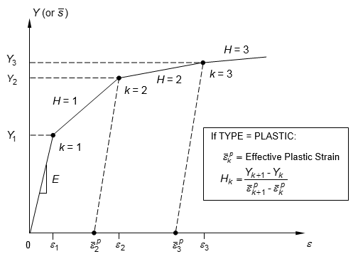

is the slope of the uniaxial stress-strain curve in the plastic region. See Figure 1.
Figure 1. Stress-Strain Curve Definition When H is Specified in Field 5

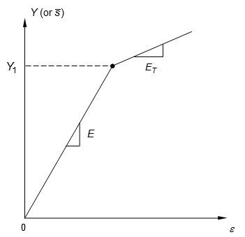

Figure 2. Stress-Strain Curve Definition When TID is Specified in Field 3
