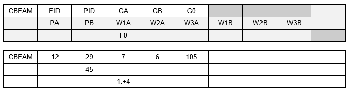

Description: Defines a beam element.

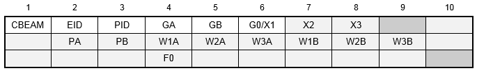

Format:
Example:
Alternate Format and Example:

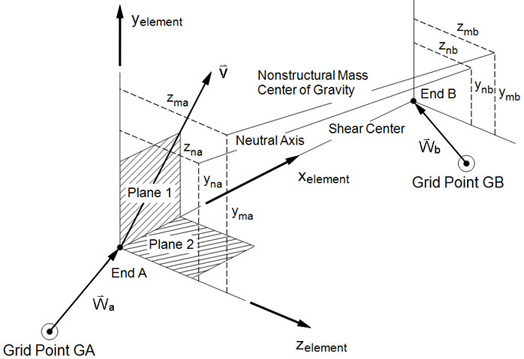

WiA, WiB | Components of offset vectors
Real or blank | 0.0 |

Figure 1. CBEAM Element Geometry System

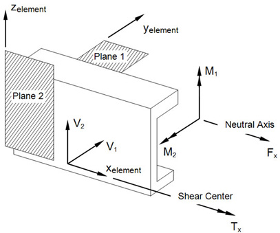

Figure 2. CBEAM Internal Element Forces and Moments
