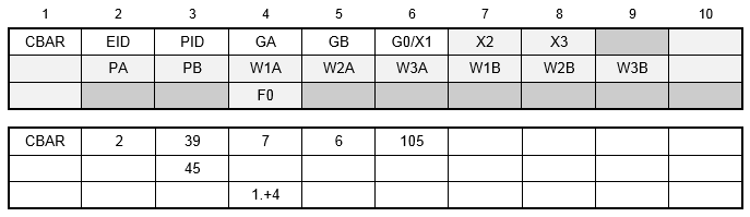

Description: Defines a simple beam element.
Format:
Example:

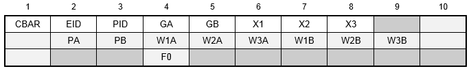

Alternate Format and Example:
Field | Definition | Type | Default |
EID | Element identification number. | Integer > 0 | Required |
PID | Property identification number of a PBAR entry. | Integer > 0 | Required |
GA, GB | Grid point identification numbers of connection points. | Integer > 0; GA ≠ GB | Required |
X1, X2, X3 | Components of vector
Real or blank | |
G0 | Grid point identification number to optionally supply X1, X2, and X3. Direction of orientation vector is GA to G0. | Integer or blank | |
PA, PB | Pin flags for bar ends A and B, respectively (up to 5 of the unique digits 1-6 anywhere in the field with no embedded blanks). Used to remove connections between the grid point and selected degrees of freedom of the bar. The degrees of freedom are defined in the element's coordinate system (see Figure 1). The bar must have stiffness associated with the PA and PB degrees of freedom to be released by the pin flags. For example, if PA = 4 is specified, the PBAR entry must have a value for J, the torsional stiffness. | Integer > 0 or blank | None |
WiA, WiB | Components of offset vectors
Real or blank | 0.0 |
F0 | Preload. | Real or blank | 0.0 |

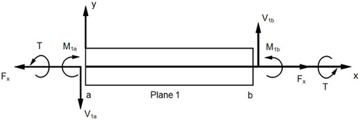

Figure 2. CBAR Element Internal Forces and Moments (xy-Plane)

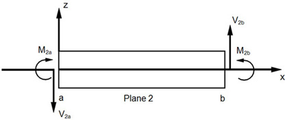

Figure 3. CBAR Element Internal Forces and Moments (xz-Plane)
