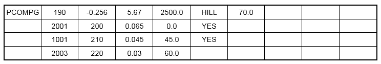

PCOMPG
Layered Composite Element Property
Description: Defines the global plies and properties of an n-ply composite material laminate.
Format:
Example:
Field Definition Type Default
PID Property identification number. Integer > 0 Required
Z0 Distance from the reference plane to the bottom surface. Real -1/2 element thickness
NSM Nonstructural mass per unit area. Real 0.0
SB Allowable inter-laminar shear stress of the bonding material (allowable interlaminar shear stress). Required if bond shear failure index/strength ratio is desired. Real > 0.0
FT Ply failure theory. The following theories are allowed. (If blank and not specified on the referenced MIDi entry, then no failure calculation is performed.)
HILL for the Hill theory
HOFF for the Hoffman theory
TSAI for the Tsai-Wu theory
STRESS for the maximum stress theory
STRAIN for the maximum strain theory
LARC02 for the NASA LaRC theory
PUCK for the Puck PCP theory
Character or blank
TREF Reference temperature. See Remark 4. Real 0.0
GE Structural element damping coefficient. See Remarks 13 and 14. Real 0.0
LAM Laminate option, one of the following character variables: SYM, HCS, FCS, ACS, SME, or SMC. If LAM = SYM, only plies on one side of the element centerline are specified. The plies are numbered starting with 1 for the bottom layer. If an odd number of plies is desired with LAM = SYM, then the center ply thickness (Ti) should be half the actual thickness. If LAM = HCS, LAM = FCS, or LAM = ACS, a composite sandwich is defined for the purpose of facesheet stability index output. HCS specifies a honeycomb core material, FCS specifies a form core material, and ACS selects either HCS or FCS based on the core material specified. If LAM = SME, the ply effects are smeared and the stacking sequence is ignored. If LAM = SMC, a composite sandwich is defined using equivalent orthotropic properties. See Remarks 8 through 10. Character or blank If blank, all plies must be specified
GPLYIDi User defined global ply identification number. Integer > 0 Ply number
MIDi Material identification number of the various plies. The plies are identified by serially numbering them from 1 at the bottom layer. The MIDs must refer to MAT1, MAT2, MAT4, MAT5, MAT8, or MAT12Bulk Data entries. See Remark 12. Integer > 0 MID1 required, see Remark 2
Ti Ply thickness. See Remark 2. Real or blank T1 required
THETAi Orientation angle of the longitudinal direction of each ply with the material axis of the element. (If the material angle on the element connection entry is 0.0, the material axis and side 1-2 of the element coincide). The plies are numbered serially starting with 1 at the bottom layer. The bottom layer is defined as the surface with the largest -Z value in the element coordinate system. Real or blank 0.0
SOUTi Stress or strain output request, one of the following character variables: YES or NO. Character NO
